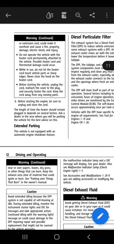

I reread and reread this little one line paragraph... Extended Parking...with a smile on my face. Glad I waited for the 21 model.

Here is the 2021 3.0 Duramax supplement owners manual.
Haven't compared both closely, but the 21's manual has a paragraph saying this model does not have the dreaded extended parking shut down timer...
I don't think that is true. I only say this because I left my truck running and I came back about 25 minutes later and the truck was off...
