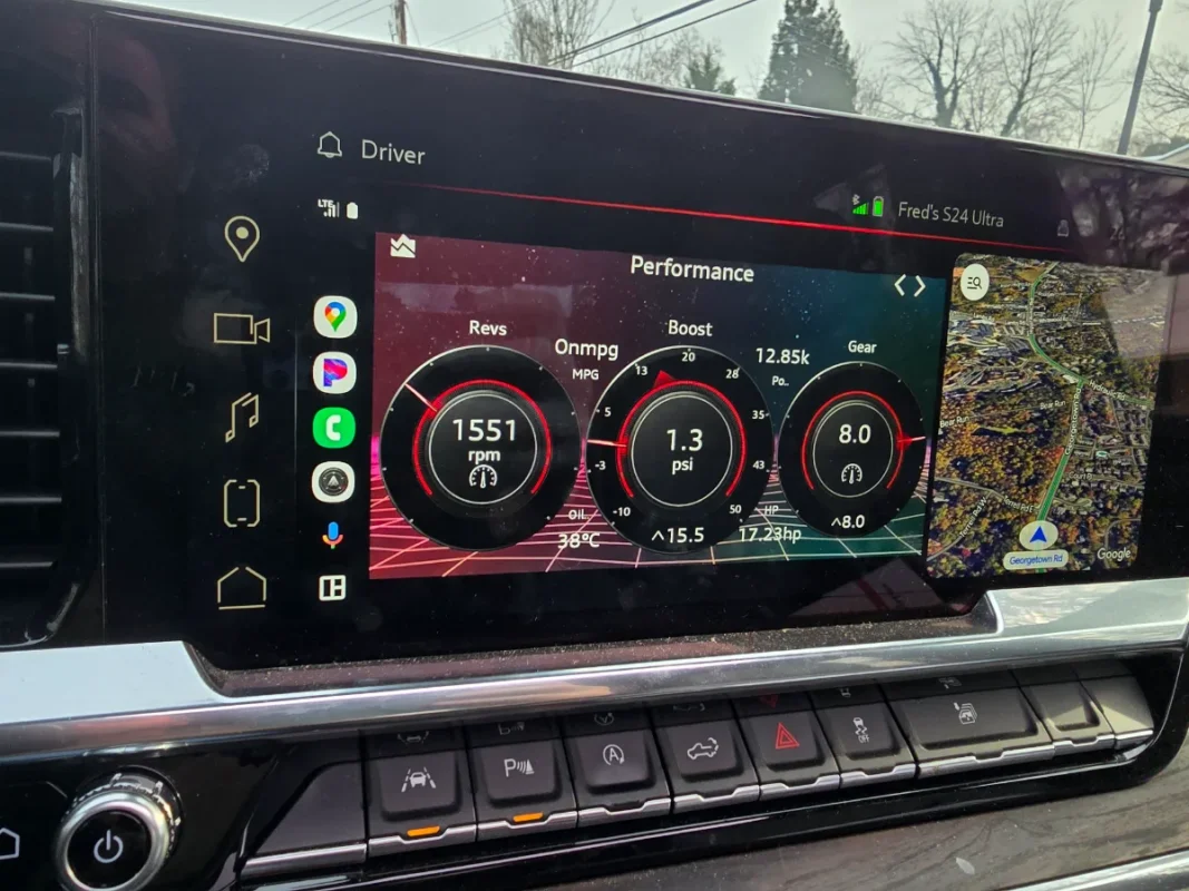

Installed torque pro on this from the playstore...

It just like having an android phone displayed on the screen.

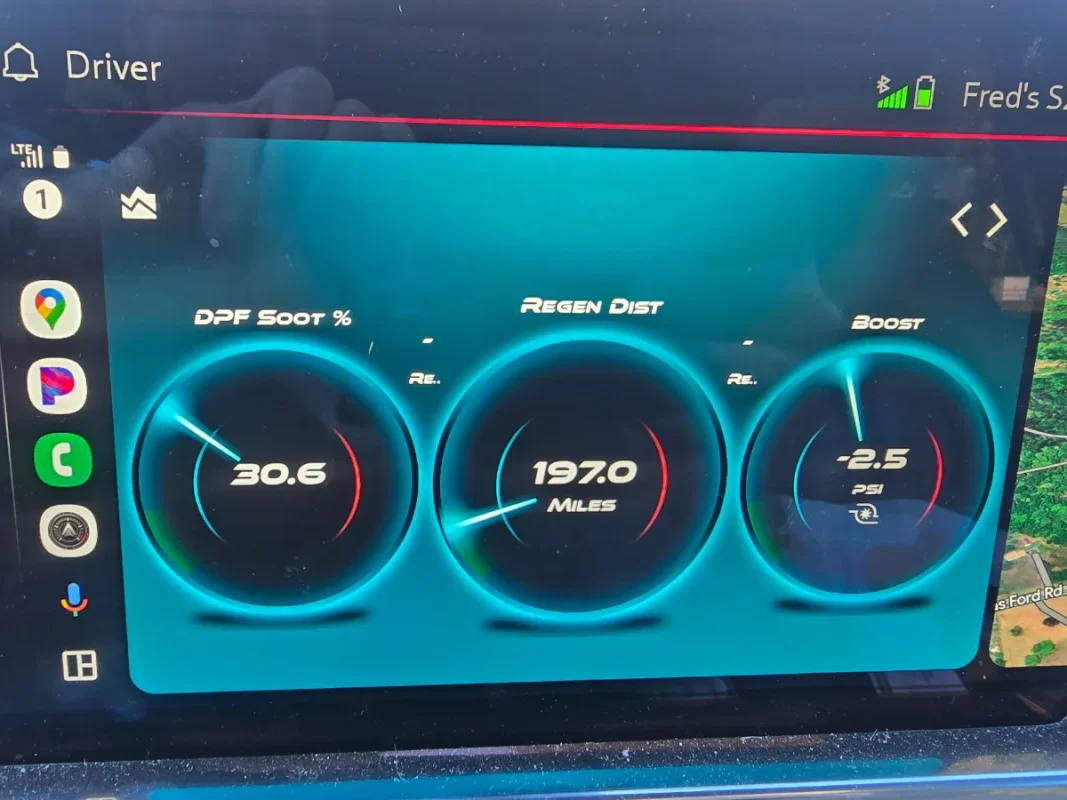

Here are screenshots of the pids you need to create in torque. The first 1 is the pid for how long till next regen. You can name it what you want. I named it Regen Dist.
View attachment 148View attachment 149Second screenshot is a yes/no, on/off pid. I named it Regen.

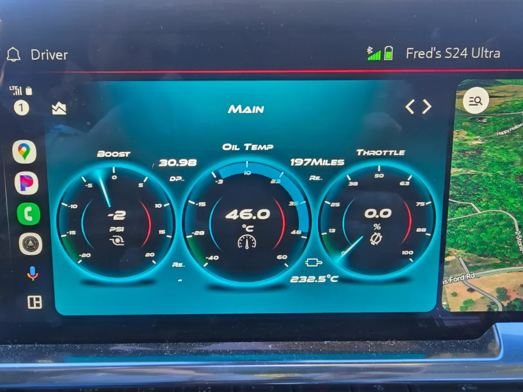

Latest set of gauges... Trans temp is still not working, need to find another pid for that one
It's amazing how quickly the soot percentage goes up in city driving, especially if you floor it from a stop. I'm looking forward to seeing how my regen status shows once I hit 100 % to see if it's accurate or not. I'll update once I do. In my daily driving today I went from ~31% to ~38% and varied in between. The value that shows 197 miles is basically static, because it's the average distance between regens. I can verify this with a real scan tool (Autel) that will also allow me to do a forced regen. I was hoping my ODBLink mx +, which is the bluetooth module I purchased and has an accompanying app, would give me that option, but it does not appear to be the case. That said, knowing my soot % and current regen status should give me enough feedback to avoid having to do so in the future.
ODBLink does have a native android auto app, but it will only display text/strings/numeric values. The nice thing about Torque is you're able to create custom PIDs and, as documented on my above linked post from gm1500diesel.com

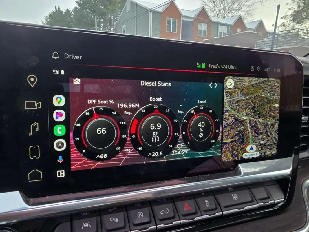

Here's my latest. I haven't had the opportunity to get into an active regen yet, so I don't know if the small (non-dial) values will populate properly when I do. I've attached a csv export of my custom torque pids if anyone wants to import them into their app. You'll need to change the extension to csv from txt, the forum would not allow me to post a csv.

I finally had the opportunity to go into a regen last night. My soot level had been hovering between 90-100 all week, but I had just being doing short 4 mile trips to my office and back and not getting a chance to warm it up. My text conversion didn't work properly, but the number indicator did. I decided to hop on the highway to do a purge and see how it was represented. Some interesting observations while it ran:
  • The real-time soot monitor came static during the entire duration the DPF monitor indicated it was in an active regen, which was about 10-11 miles. I thought perhaps it was stuck, but it seems to just be dormant during that time
  • Once the active regen indicator went off, my soot level dropped immediately to 30 percent. So I'm guessing the sensor doesn't gather data while in an active regen, and an Active regen is terminated once the DPF itself hits 30 percent
  • I still had 5-6 miles to get drive home. During that time, despite not being in an active regen, my soot continued to drop to 2 percent. At that point I was in local traffic and I ended my trip at 3%
  • My average miles between regens jumped from 196 to ~243 after it was done. To me, that implies it is not the average across all regens, but the actual mileage between the last regen or at least an average between a very recent set of regens
I'm going to adjust my unit conversions to see if I can get text the next time this occurs.
I also get why these values (soot and regen status) are not advertised to the driver... I've basically been anxious monitoring my soot level and wondering when the regen will happen all week. I imagine there'd be lots of complaints to the dealer if a regular driver was being presented with this information at all times. After I get comfortable with it, I will probably put the diesel stuff on a lesser used dashboard and only open it up periodically to check how close I am to a regen.
