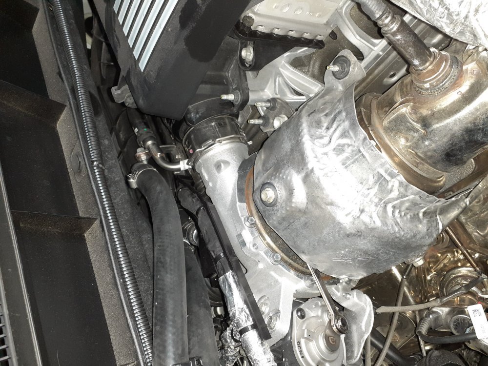

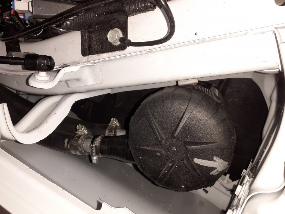

I just installed a Provent catch can on my 3.0. Wasn't the easiest mod I've made, but works so far.
Skip h.

can you post pictures? I would like to visualize the installation
Good use of that dead empty corner.
Really interesting to see one finally. Let us know how much it catches.
No update right now, This damn covid has kept me at home. Usually I'd have 2 long trip done by now.
For what it's worth, I drained 1.2 oz of oil out of the Provent catch can in 1200 miles. I should be taking a 4000 mile trip at the the start of October and will update then.

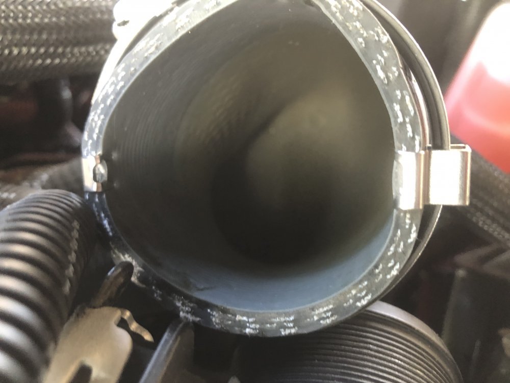

Checked my intake and it’s clean. Has a tiny bit of condensation but I had a quick short trip and it went from about 45 this morning to 90 this afternoon so no worries there. I was really surprised how clean it was… 11k miles and no catch can for me. I would imagine if I was getting a quantifiable amount that a catch can would reduce it would be noticeable in Here?

No worries there, but doesn't the blowby get "injected/dumped" directly in the manifold?

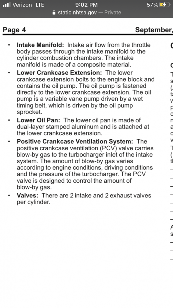

That’s a great question. Let me go check the closest thing to a schematic of the system I’ve found which is the early release bulletin to the techs back in 2019.
I was under the impression it’s routed to the compressor intake which basically is using vacuum at low boost or idle to pull pcv gasses through the oil separator build into the valve cover (I think) and then back through the compressor to start all over. And when under boost it may or may not use the same path or have a check valve that would allow boost air to do the same process. Similar to the ecotec motors but for gods sake hopefully better… regardless those are fed into the compressor also and they FILL the whole system with goo.
If it was to be dumped into the intake it would need to be at the same or slightly more psi than the intake itself
#19-NA-180 is the bulletin released awhile ago.
