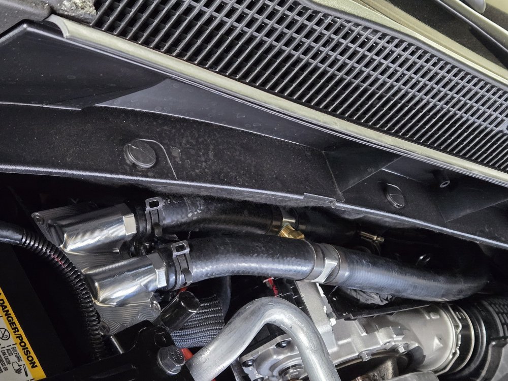

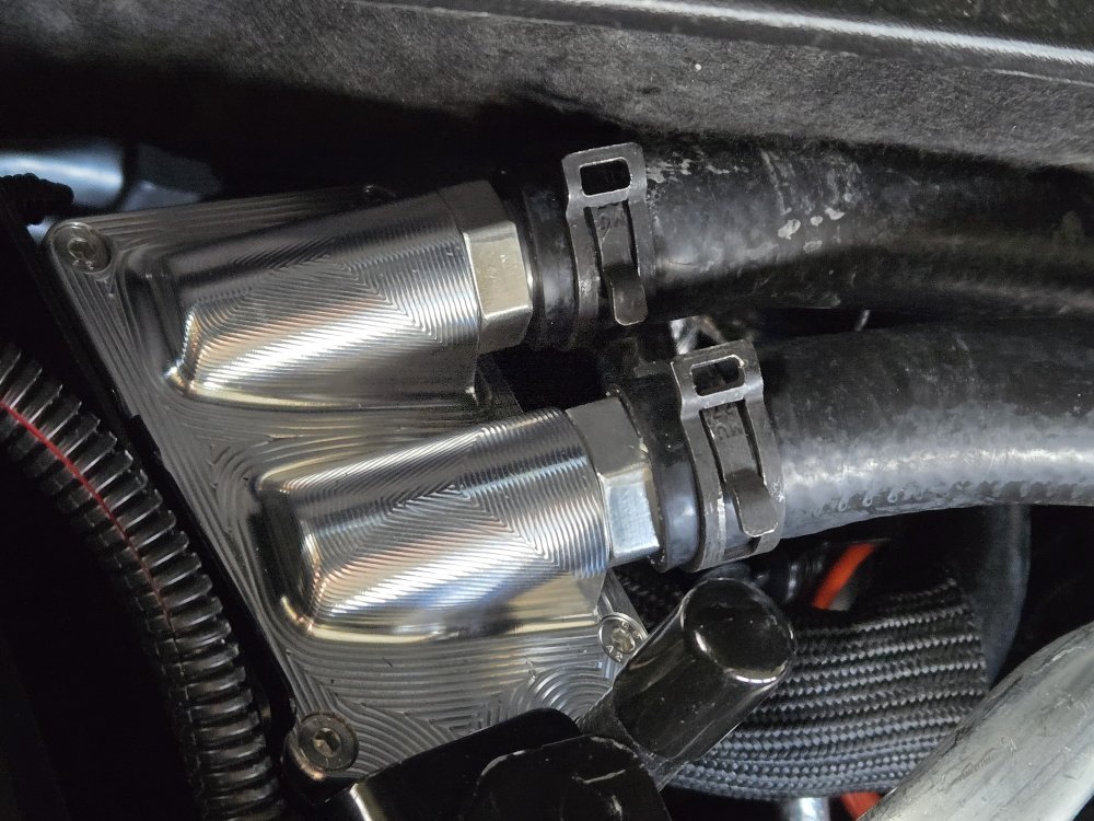

I installed the new VSE oil catch can this afternoon. (theres a good video in the attached VSE web site link and another good one on DemonWorks youtube channel)
I only have 29 miles on the vehicle since I bought it back in Dec. 2023. I don't drive my good vehicles it in the winter (because of all the salt) and I wanted to wait until this catch can became available, so I just left it parked.
The VSE can is a bit more difficult to install than what you see in the videos, but definitely doable. I had to use a regular spiral clamp on the curved hose instead of the spring clamp thats in the kit. (I wasted the $$ for that special clamp tool that is recommended and found it to be nearly useless.) There just wasn't a good way to get to the spring clamp on the curved hose, the space is very limited! I was able to use the OEM spring clamp as well as two of the three that came in the kit for three of the four connections.
If you do purchase a VSE catch can, be super careful getting the can into position. It is a really tight fit and you don't want to disturb the heater hose coupling any more than you absolutely have to. I hear that they can break fairly easily. ALSO....stuff a towel under the can BEFORE you try to thread the nut onto the mounting bolt. If you drop it, good luck finding it. (I never did find it, even after dropping the skid plate) I picked up a new nut at the hardware store, stuffed an old fluffy towel under the can, wrapped a piece of duct tape around my finger (sticky side out) then pressed the nut firmly into the glue on the tape to keep from dropping it again. I left the bolt loose enough so I could turn it and catch the threads on the nut.
I installed a Racor crank case ventilation system on my 2000 Powerstoke shortly after I bought it. 24 years later, the inlet to the turbo and all the piping, hoses and connections were 100% oil free. I am hoping that the VSE oil catch can will do as good a job as the Racor system did. Time will tell.
As an added bonus, I also got the Banks iDash gauge installed on the A pillar grab handle. The Banks gauge pod looks fantastic. The paint for the pod that is available from Banks, matches the interior color perfectly (after I got the paint manufacturer's info and part number from Banks web site, I ordered a can of it through walmart for half the price).
