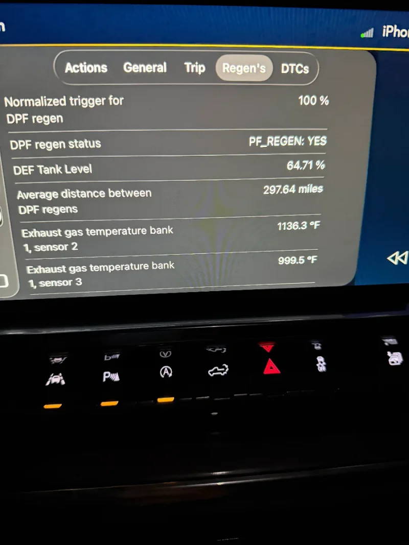

I just installed the obdlinkMX+ and I’m using the OBDfusion ($20) software because it has an Apple CarPlay app.
The screen shows the first Regen I was able to monitor progress. At 100% the status went to YES, it was done after about 10-15 minutes. I traveled 226 miles and 2 weeks since the last Regan
